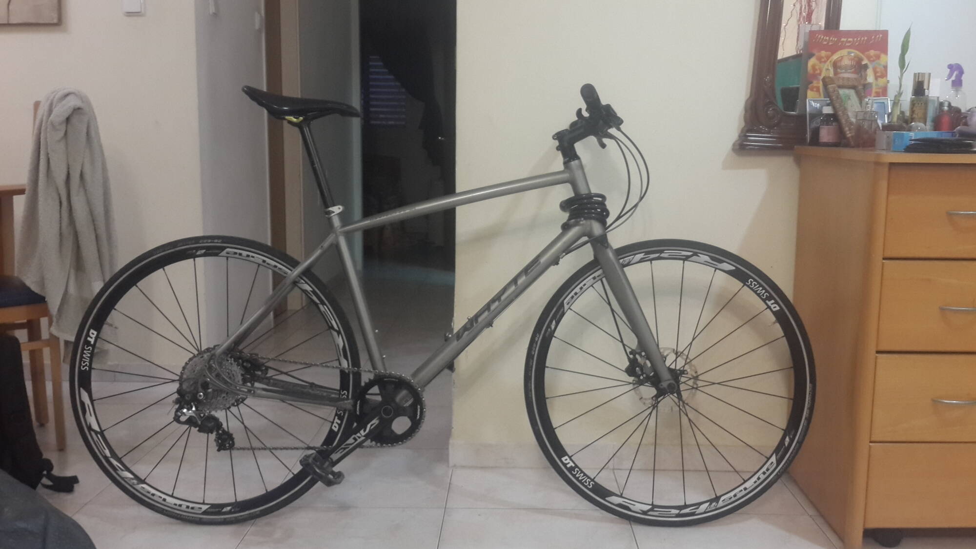

Что имели вначале
Whyte Whitechapel 2015
Colour: Matt Zinc with Grey
Frame: Size L 6061 Hydro Formed T6 Aluminium, Custom Drawn, Multi Butted with Custom Whyte Dropouts
Fork: Straight Bladed 6061 T6 Alloy Front Fork with Forged crown,
Headset: FSA No. 23 Integrated Road, 1 1/8" Sealed Cartridge Bearings, 41mm Diameter
Rear Hub: Alloy, Cup & Cone, Double Seal, 32 Hole
Front Hub: Alloy, Cup & Cone, Double Seal, 28 Hole Spokes: 2.0mm, Black Stainless with Brass Nipples
Rims: Whyte Disk Road 32mm Deep Section Rim, 32 Hole Rear and 28 Front, 3M Reflective Decals
Tyres: Vittoria Zaffiro, 700 x 28c, Black, with Puncture Protection
Shift Levers: Shimano Altus, 9 Speed
Rear Mech: Shimano Acera RD-M3000, 9 Speed
Cassette: Shimano HG-200-9, 11-34 9 Speed
Chain: KMC CN-HG53, 9 Speed
Crankset: Lasco 42T, with Alloy Chain Guard
Bottom Bracket: FSA Square Taper
Seatpost: Whyte 20mm Offset, 27.2mm x 350mm, 1pcs 3D Forged 6061 Alloy, 2 Bolt Clamp
Saddle: Whyte Custom
Handlebar: Whyte Narrow, 31.8mm, 30mm Rise, 580mm Wide
Stem: Whyte, 60mm S, 70mm M, 80mm L, 90mm XL
Grips: Whyte Custom with extra-thick bar plugs
Front Brakes: Tektro Auriga, 160mm Rotor
Rear Brakes: Tektro Auriga, 160mm Rotor
Brake Levers: Tektro Auriga
Pedals: Fibre reinforced Composite Platform
Weight: 10.4Kg
Что получилось в итоге
20160115_172227.jpg [ 703.7 КБ | Просмотров: 4170 ]
Rear Hub: Alloy, Cup & Cone, Double Seal, 32 Hole DT Swiss R24 Disc Wheelset + Shimano RT76 160mm Rotor
Front Hub: Alloy, Cup & Cone, Double Seal, 28 Hole Spokes: 2.0mm, Black Stainless with Brass Nipples DT Swiss R24 Disc Wheelset + Shimano RT76 160mm Rotor
Rims: Whyte Disk Road 32mm Deep Section Rim, 32 Hole Rear and 28 Front, 3M Reflective Decals DT Swiss R24 Disc Wheelset
Tyres: Vittoria Zaffiro, 700 x 28c, Black, with Puncture Protection Schwalbe Durano plus 700c 1"
Shift Levers: Shimano Altus, 9 Speed Shimano Saint M820
Rear Mech: Shimano Acera RD-M3000, 9 Speed Shimano Saint M820
Cassette: Shimano HG-200-9, 11-34 9 Speed Shimano ultegra 12-30 10sp
Chain: KMC CN-HG53, 9 Speed Campagnolo record 10sp
Crankset: Lasco 42T, with Alloy Chain Guard Shimano Saint M820 + Garbaruk 34T
Bottom Bracket: FSA Square Taper Shimano Saint BB80 Hollowtech II
Handlebar: Whyte Narrow, 31.8mm, Flat, 620mm China Carbon
Stem: Whyte, 80mm
Grips: Whyte Custom with extra-thick bar plugs Crank Brothers Cobalt
Front Brakes: Tektro Auriga, 160mm Rotor Shimano SLX 675
Rear Brakes: Tektro Auriga, 160mm Rotor Shimano SLX 675
Pedals: Fibre reinforced Composite Platform Shimano Saint MX80
Weight: 10.4Kg Х.з. не взвешивал :)

в ближайших планах установка света, багажника под быстросъемную корзину, замена тормозов на СЛХ/ЗИ/сайнт/ХТ пока не решил что именно, в отдаленных планах замена палок, рамы, вилки.

Красивый, только на кой черт saint тут то? :o
Все элементарно, начала хрустеть стоковая каретка подумал о замене всей системы на что то более совершенное чем квадрат, из критериев было отсутствие переднего переклюка т.е. сингл спереди и ....... оказалось что я могу выбирать только в пределах 10-11 скоростей. 11-х система выбивалась из бюджета поэтому ХТ/ХТЯ отпали сразу, экспериментировать с со всяким срамом была неохота, поэтому выбор сузился до Зии/Сайнт. В выборе победила исключительно эстетика сайнтов и они хоть и со скрипом но помещались в мой бюджет, а пока ехала большая часть запчастей случайно наткнулся на отличную мивцу на колеса и в результате поменял и их :).

нашел классную фотку на которой видно как велосипед эволюционирует из одного состояние в другое. Стадия куколки бля :)

Был фитнесс-байк, получилась какая-то херня.
P.S. Сэйнт здесь выглядит как говно.

ну так покажите свой, а я поучусь как правильно собирать велосипеды :)

рама развалится раньше сейнта)

вполне себе нормальная рама ..... хотя в планах 920 трек ..... к лету думаю созрею на замену.

Однозначно не хватает четырехпоршневых тормозов.
203 роторов.
и руля 910мм.
Обслуживание вилок и амортов, принимаем заказы из других городов.

Какой тонкий юмор, сможете посоветовать лучшую в этом бюджете трансмиссию 1х10 ? И объективно расписать ее плюсы в сравнении с моим выбором?

а для каких целей используется велосипед?
