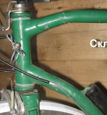

Tourist is very low quality frame, compare to Sport:
- Tourist is no-alloy steel, ~2x less strong
- Tourist is no-seamless tubing, ~2x further less strong. Despite heavy-weight ~3 kg it is not durable
There are dozen of Tourist frames in our sport-school, all of them look like this:
at the same time, dozens of Starts/Sports frames are in good shape
- fork is ~1 kg
- instead of aluminum alloy stem - steel tube, which is connected to steel stem with ugly bolt
- no hardware for anything: brake cables, shifters, FD, bottle cages.
- Brakes are of centre-pull tipe (no dual-pivot or single-pivot as in Sport), instead of wire casing - they use pulleys clamped to headtube and seatpost clamp.
