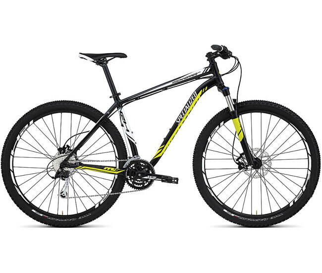

АГА)))) Загорелся ROCKHOPPER 29'12
Надо только свой продать))
A подробнее он такой))
РАМА Specialized M4 29" fully manipulated alloy frame, fully butted, disc only, externally relieved HT, forged dropouts w/ replaceable derailleur hanger
АМОРТИЗАТОР
ВИЛКА SR Suntour XCR 29" (SF11-XCR-DS-26-LO-SP), magnesium lower, 30mm steel stanchions, 1-1/8" alloy steerer, hyd. damping w/ Specialized Spike Valve and alloy LO cartridge, 80mm travel
РУЛЕВАЯ Integrated 1-1/8" threadless, Campy-style, full cartridge bearings
ВЫНОС 3D forged 6061 alloy, 4 bolt clamp, 7º rise, 31.8mm
РУЛЬ Flat bar, double butted alloy , 680mm (S) or 700mm (M, L, XL, XXL) wide,10º backsweep, 4º upsweep, 31.8mm
ГРИПСЫ Specialized Body Geometry XCT Men's, dual compound, Kraton rubber, closed end, 130mm
ПЕРЕДНИЙ ТОРМОЗ Tektro Draco hydraulic disc brake, post mount, 180mm 6-bolt rotor
ЗАДНИЙ ТОРМОЗ Tektro Draco hydraulic disc brake, post mount, 160mm 6-bolt rotor
ТОРМОЗНЫЕ РУЧКИ Tektro Draco hydraulic
ПЕРЕДНИЙ ПЕРЕКЛЮЧАТЕЛЬ Shimano Acera, 9-speed, 34.9mm clamp, top-swing, dual-pull
ЗАДНИЙ ПЕРЕКЛЮЧАТЕЛЬ Shimano Alivio, 9-speed, SGS cage
МАНЕТКИ Shimano Acera, 9-speed Rapidfire plus, SL type w/ optical display
КАССЕТА Shimano 9-speed, 11-34t
ЦЕПЬ KMC X-9, 9-speed, reusable Missing Link
СИСТЕМА SR Suntour, 9-speed, Octalink spline
ЗВЕЗДЫ 44/32/22, replaceable outer
КАРЕТКА Shimano, Octalink spline, cartridge bearing, 73mm
ПЕДАЛИ Composite plastic body, loose ball w/ reflectors
ОБОДА Alex RH Disc 29", alloy double-wall, 28mm, pin joint, 32h
ПЕРЕДНЯЯ ВТУЛКА Formula disc hub, high-low flange, double-sealed loose ball, machined disc mount, QR, 32h
ЗАДНЯЯ ВТУЛКА SBC alloy, mid flange, double-sealed, ground race, machined disc mount and flanges, cassette, QR, 32h
СПИЦЫ Stainless, 2.0mm (14g)
ПЕРЕДНЯЯ ПОКРЫШКА Specialized The Captain Sport, 60 TPI, wire bead, 29x2.0"
ЗАДНЯЯ ПОКРЫШКА Specialized The Captain Sport, 60 TPI, wire bead, 29x2.0"
КАМЕРЫ Presta valve
СЕДЛО Specialized Body Geometry Rockhopper, steel rails, 143mm width
ПОДСЕДЕЛЬНЫЙ ШТЫРЬ Alloy, 2 bolt head, 30.9mm, 12.5mm offset, micro adjust
ЗАЖИМ ПОДСЕДЕЛЬНОГО ШТЫРЯ 34.9mm, forged alloy, extruded QR lever
ДОПОЛНИТЕЛЬНО Chainstay protector, reflectors, clear coat, owner's manual
sp_ss-12_7.jpg [ 64.03 КБ | Просмотров: 2827 ]

Многое улучшено с Рокхоппера 2009-го года, ну кроме трансмиссии конечно (СРАМ 4/5 против Шимано Асера/Аливио, и 8-рик против 9-ти). А так спиц на переднем колесе побольше, руль пошире, рулевая на промах вроде, педали топталки, а не макеты, каретка 73 мм, сами спицы не 1.8, а 2.0 мм и втулки получше. То есть немного покрепче получается. Хотя нет сдвижных дропаутов (правда кому они там нужны с не очень жесткой рамой) и к бюджетной гидравлике Тектро я отношусь предвзято. Но так ничего. Хотя эти уж мне попугайские расцветки...
На месте же автора, я бы всё равно не спешил. На Аспекте стоят дисковые тормоза, а значит можно легко найти дешевые колеса на 28" под диск (обычно стоковые) и поставить покрышки, что влезут. И катать на них асфальт с превеликим удовольствием.
Ну если уж просто хочется Спеш, то тут ничего не поделаешь :D
