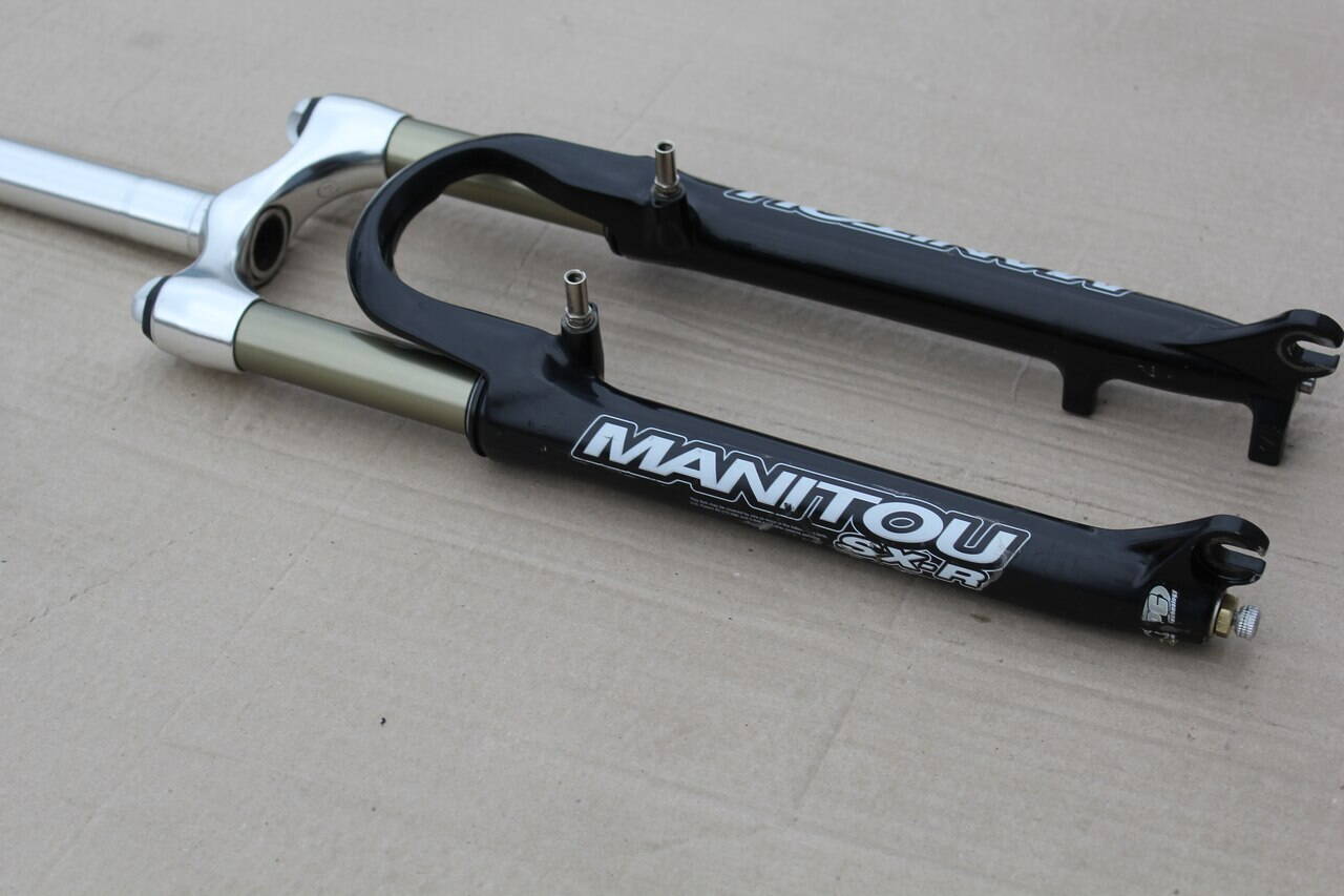

сколько масла лить в каждую ногу вилки Manitou SXR ?
или может есть ссылка у кого-то на мануал?
находил за другую вилку мануал так там пишется что масло заливается в миллиметрах по какому-то расчёту.
вот:
The MRD Anti Bob shaft locates the compression piston higher in the
chamber than a normal TPC compression rod, so oil must be added for proper
function of the lockout. Proper oil height can be measured with a simple dip
stick, which you can put down into the fork leg. The proper oil height, measured
from the top of the left leg and extending down into the leg, is between 3.75
inches (95mm) and 4.25 inches (108mm). Use Maxima SAE 5-weight oil only
W
arning: DO NOTOVERFILLTHE FORK WITH OIL. OVERFILLING
THE FORK COULD CAUSE DAMAGE
TO
THE FORK AND POSSI
BL
Y
INJURE THE RIDER.
Комментарий к файлу: Manitou SXR
M9mnwB16IU4.jpg [ 132.65 КБ | Просмотров: 1097 ]

Мануал уже дали, что даже рассказали и опять здрасте.
Ну неужели тяжело прочитать оглавление того мануала
что дали? открываем читаем.
Chapter8: Damping Assemblies
4. Checking fork oil level
Листаем и находим
Having the correct oil level is critical to keep your TPC fork working at its best.
To measure the oil level, you only need a measuring tape. Begin by unscrewing
the compression valve assembly at the top of the left fork leg. Leave the spring
stack (rider’s right side) installed as it should not be removed to check oil
height.
Once the assembly is completely unthreaded from the inner leg, pull the assembly
about halfway out. You should be able to feel when the piston is no longer
in the fork fluid. When this happens, slowly lower the assembly to where it
again contacts the oil (felt by the increased resistance of the piston in the oil),
and measure the distance from the top of the crown to the top O-ring (located
under the knob above the cap threads). This distance should be approximately
two inches
Ну что непонятного? или еще перевести?
