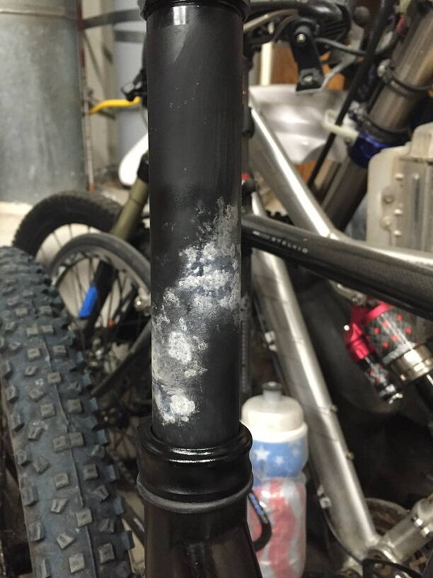

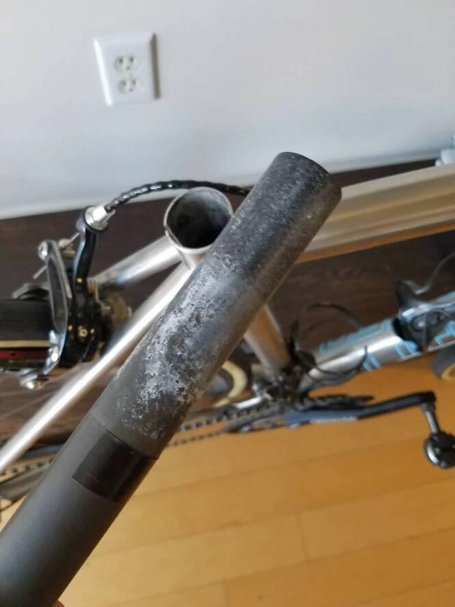

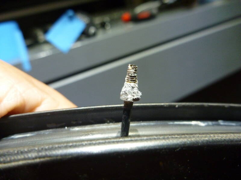

Ось boeing.com пише:
"Fiber-reinforced plastics are corrosion resistant, but plastics reinforced with carbon fibers can induce galvanic corrosion in attached aluminum structure."
"For example, graphite fibers, which are used to reinforce some plastic structure, present a particularly challenging galvanic corrosion combination. The fibers are good electrical conductors and they produce a large galvanic potential with the aluminum alloys used in airplane structure. The only practical, effective method of preventing corrosion is to keep moisture from simultaneously contacting aluminum structure and carbon fibers by finishing, sealing, using durable isolating materials such as fiberglass, and providing drainage"
Оці наші інтернетики
cfc1.jpg [ 178.82 КБ | Просмотров: 2444 ]
cfc2.jpg [ 95.99 КБ | Просмотров: 2444 ]
cfc3.jpg [ 88.44 КБ | Просмотров: 2444 ]
